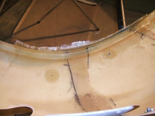

Brief Description:  Reinforced door sill
Added two layers of fiberglass cloth to the left side door sill along the bottom to re-enforce it where I will be getting in and out of the helicopter.

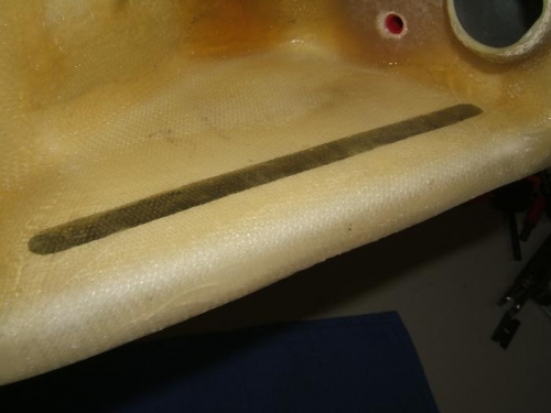

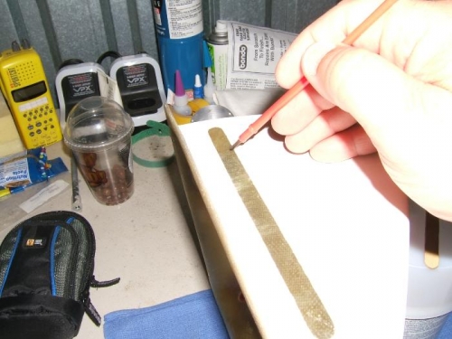

Brushed on a thin coat of resin to the inside and outside of the sight gauge on the turbine oil tank to thicken it back up and fill air pockets that were revealed when the gauge was sanded into the gel coat. This also makes the glass smoother and more transparent in this area.
Two layers of cloth added to door sill
Thin coat of resin on inside of sight window
Thin coat of resin brushed onto outside of sight window
