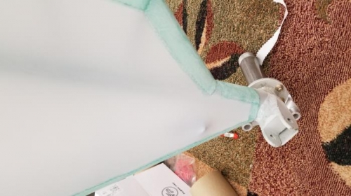

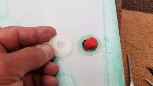

Brief Description:  Landing Gear Covering Part 6
Well, what to do for the brake line fitting exit. I shrunk the fabric and got it tight around the fitting. I took an xacto knife and cut the hole then sealed the edges with a soldering iron. I then had these huge drain grommets that I modified for the hole and glued them in place. Nice and clean. They will get a doily later on.
