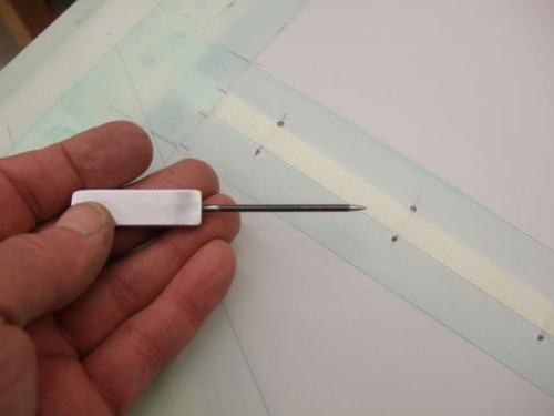

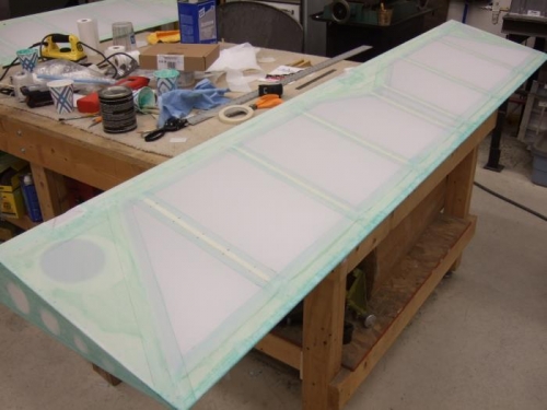

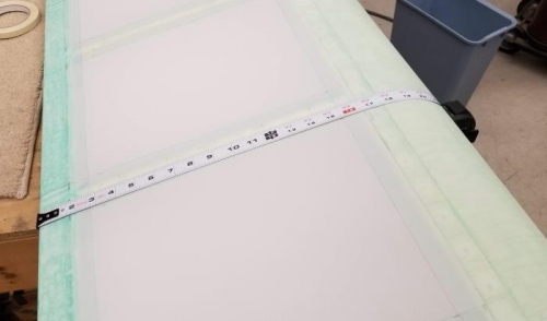

Not much to say other than it's time to do some stitching. I transferred all the layout markings to both sides of the flaps, cut and laid down the reinforcing tape and stitched it all down. The beginning knot is a square knot with a half-hitch on both sides, followed by the “Superflite knot” and terminated by the Superflite knot followed by two half-hitches. All in all it worked out great!
