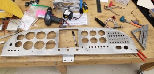

Brief Description:  Instrument Panel Part 11

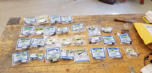

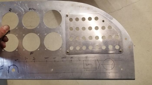

I installed the nutplates and fit the plate to the panel. I took all the breakers and labeled them for each purpose just to make sure that I ordered enough and they were the correct ones for what I was doing. What took the longest and was the one I had to think about far too long was the switch placement. I really took a lot of time trying out different combinations and spacing. I finally settled on a configuration and drilled the holes. There were also considerations behind the panel. For example I wanted the ignition switch on the first row, but there is a diagonal tube that goes to the top center motor mount and there is no way the switch would fit in that spot. So it moved up and the others moved down.
