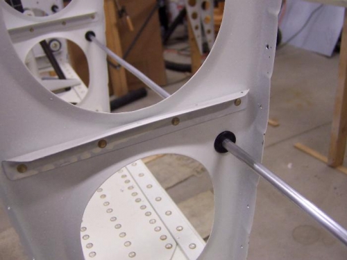

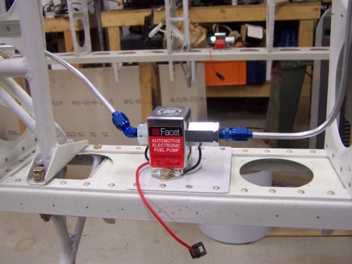

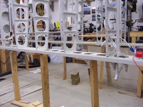

I ran the rest of the fuel line from the aux tank. I drilled a hole in the ribs, installed a grommet and ran the line from the tank to the inboard bay.
Fuel Line From Aux Tank
Line Passing Through Ribs
Aux Fuel Pump Plumbing
