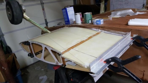

4/16 3 sanded right stub wing to contour and floxed gear leg on. Also started instrument panel

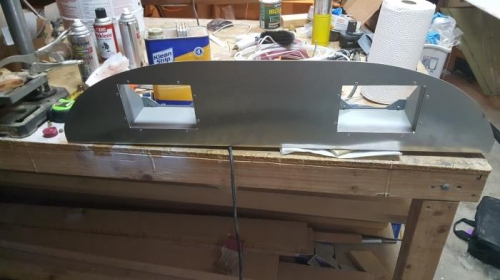

4/17 5 fiberglassed right stub wing and started cutting instrument panel for efis/ems
4/18 3 flipped airplane to start lower stub wings and worked on panel more
4/19 4 glassed lower right stub wing
4/20 3 cut foam for left lower stub wing. Cut and sanded right trailing edge. Drilled static tube and plugged end.
4/21 3 glassed inside left stub wing for wing walk. Glued and sanded outside to contour. Had machine shop bend instrument panel then riveted dynon support brackets on.
4/22 2 glassed lower left stub wing and started running tubing for pitot/static.
