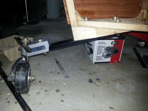

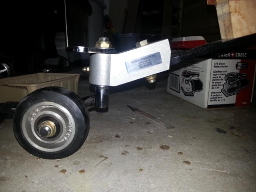

Brief Description:  Tail wheel mounted
I bent my homemade leaf spring with a torch and hammer, drilled the holes for the fuselage and then painted it black. The spring was then clamped to the fuselage, centered and bolted on. I had to bevel two washers on each bolt to make the nuts torque flush.
