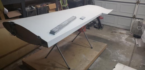

12/14 1.5
Applied primer to left wing top
12/15 1
Sanded primer up to 600 grit
12/16 1
Filled all pinholes and pits with putty
12/17 1
Flipped wing and applied smooth prime
12/18 1.5
Shop cleanup
Started block sanding wing bottom
1/5 2
Block sanding wing
Sprayed on more smooth prime
1/6 1
Block sanded with 180 grit
1/7 .5
Sanded to 220 and filled imperfections
1/9 1
Prepped for primer
1/11 1
Primed wing bottom
1/12 3
Sanded off primer due to flow out issues
1/19 4
-Removed engine
-Installed top cowling camlocs
-Installed usb port
-Fabricated and installed headset jack mounts
-wiring cleanup
1/20 4
-Primed left wing bottom again. Had problems with spatter. Suspect faulty gun part/user error.
-microed rudder
-filled gap between canopy and forward deck
re-created joggle between cowling and forward deck
1/22 1
Sanded primer in prep for re-spray
1/25 1
Bodywork

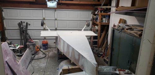

1/26 6
Bodywork
Flipped plane
Worked on fillets
