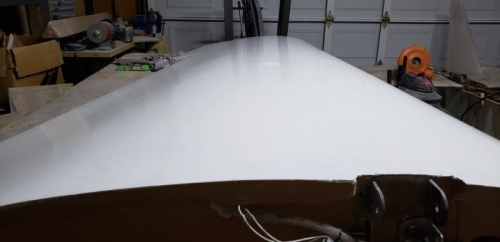

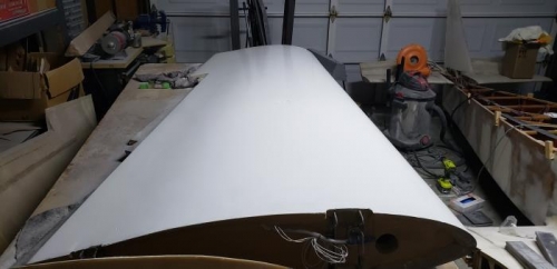

Brief Description:  wing bodywork
11/16 1.5
Block sanding
11/17 1.5
More wing sanding
11/18 1.5

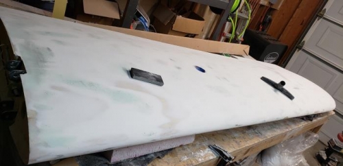

-Final sanded first rough fill to 80 grit
-Filled low spots with cabosil/micro mix
11/19 1
-Started blocking second coat
11/20 1
-more sanding
11/22 1
-Final block sand with 100 grit
-applied 3 coats of smooth prime
11/23 1.5
-block sanded with 180/220
12/2 1
Final sanded w/220
