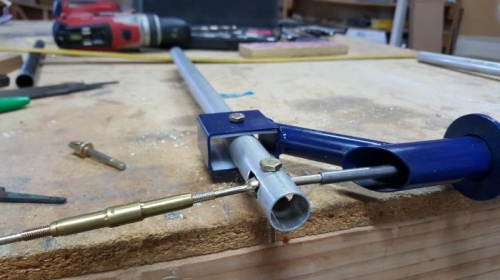

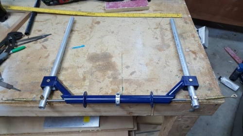

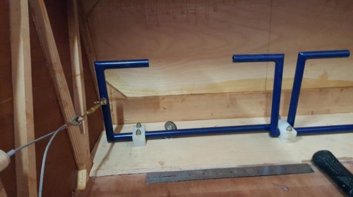

Brief Description:  control stick and rudder pedals
I started out by painting my control stick and rudder pedals blue. Then the rudder pedals were drilled for the control cable and run around cable. The rudder pedals were installed and I made the final length adjustments on the control cable.
I cut the control sticks to length and drilled holes to mount them. Then I tapped the shuttle rod and installed eye bolts with locktite 620 to link the sticks together.
