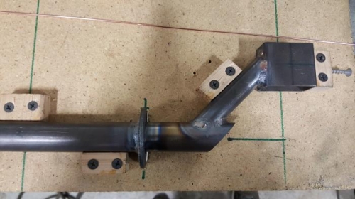

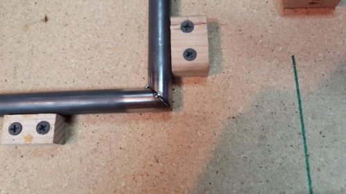

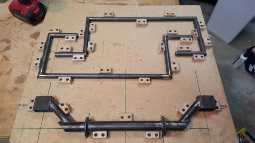

Date:  1-30-2016
Number of Hours:  10.00
Brief Description:  Finished welding
I found somebody that would let me mess around with his TIG welder until I figured it out. After several sessions I felt confident enough to fabricate my control stick and rudders. Everything was cut, chamfered, cleaned and jigged on plywood. After everything was tack welded, I removed them from the jig and finished the welds
