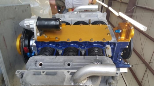

Brief Description:  Finished engine at CC35

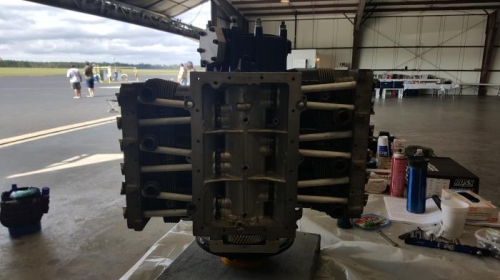

Day two of Corvair College #35
-Installed pushrods and rocker arms
-Adjusted valves per WW manual
-Installed oil pickup
-Trimmed oil dipstick
-Installed oil pan
-Installed WW low profile starter kit
-Gapped spark plugs at .35 and installed
-Made spark plug wires to fit

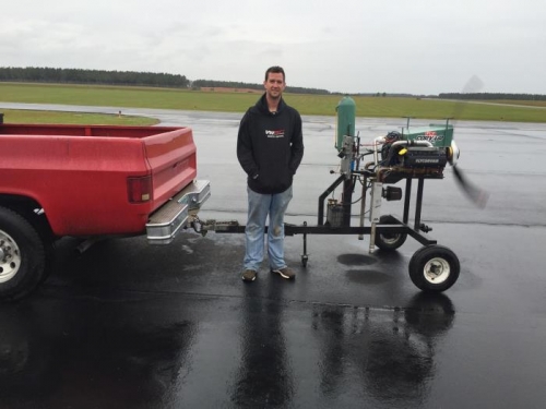

-Installed engine on test stand and primed oil system
-Installed valve covers
-Ran engine next day. Found one oil leak at oil pan. Will fix before next run.
