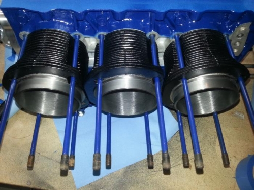

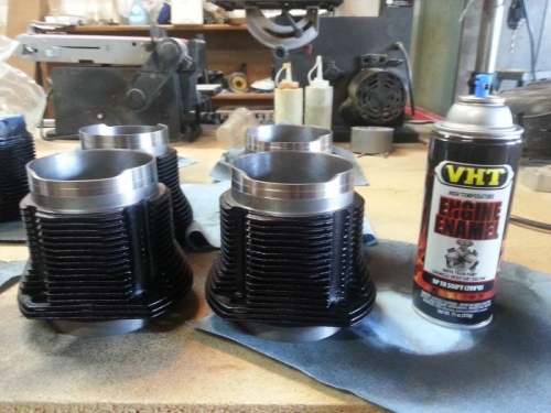

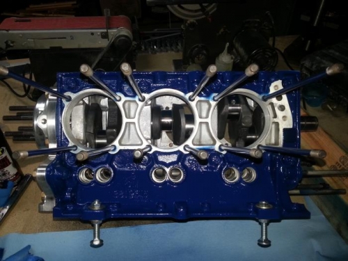

I spent a little time painting my case and jugs. I started by de-greasing and cleaning the cylinders. Then I painted them with high temp black paint. After everything dried, I oiled up the unpainted surfaces with assembly lube (50/50 STP and 15w40) and put them back in their plastic covers. Then I taped off the machined sufaces on the case and painted the engine with dark blue caliper paint.
