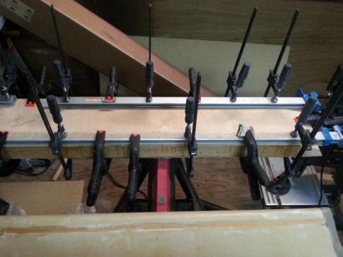

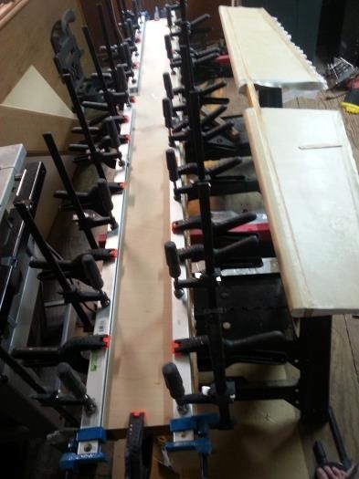

Date:  6-9-2013
Number of Hours:  1.25
Brief Description:  Closed main spar
I closed out my main center spar today. I covered one side of the plywood completly with T-88 so that it would be sealed when dry. I used some long bar clamps to spread out the pressure applied with all of the clamps.
