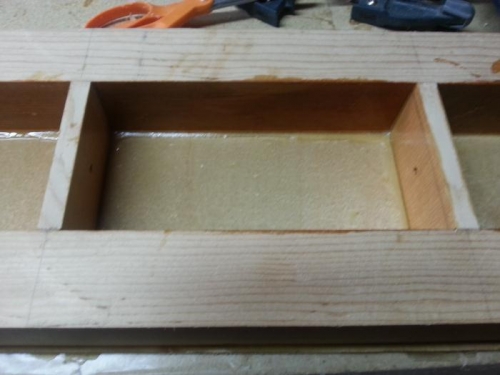

Today I sanded the verticals flush with the spar caps on my main center spar. Then I varnished the inside with thinned out T-88. After that, I cut and scarfed the plywood that will close it out.
