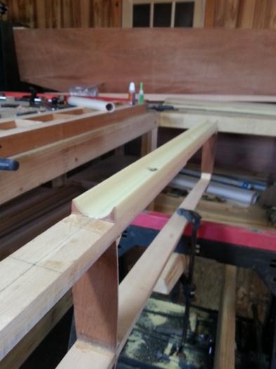

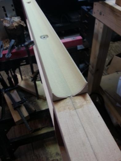

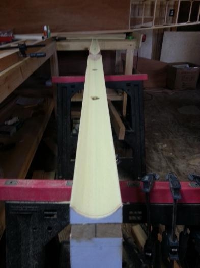

Brief Description:  Horizontal stabilzer gap seals
I decided to sand the gap seals before filling in the foam between the front two spars. This way I could sand it to shape before permanently installing the rod end bearings. Without the hinges in the way I was able to quickly sand it to shape with a broom stick with sandpaper glued to it.
