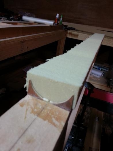

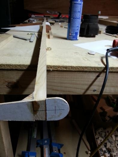

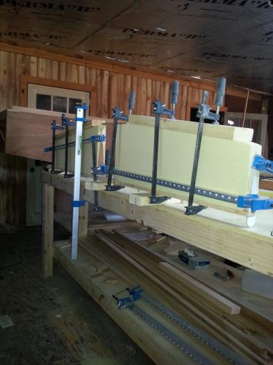

Since I am using the "Dr. Dean" hinges, I drew my own gap seal templates in CAD to account for the hinge point being moved back to .47" I printed them out, glued them to some scrap ply and then glued the templates to my spars. Once the glue dried, I glued in some foam on the hinge area and elevator with gorilla glue.
Gluing elevator foam in
