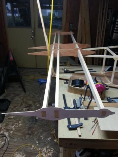

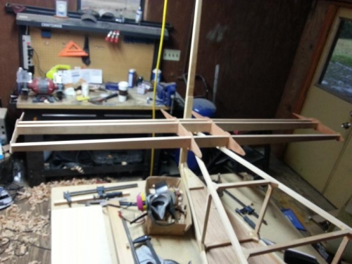

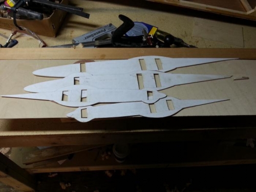

I cut out and sanded the spar holes in my templates and then sanded the edges to the airfoil lines. Then I re-tapered the spars to have the inboard templates 4" from the center line per the plans. I spent some time fine tuning the spars by sanding so all of the templates slide on perfectly. When I was done for the day, the UPS man greeted me with my new hinges and composite material.
