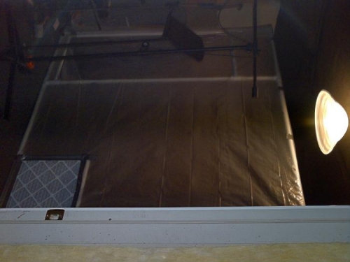

Brief Description:  Building paint booth
The airplane shop just keeps encroaching on the recording studio. Tonight I built a paint booth in the only remaining recording room I have. I built it out of 1" PVC pipe and 4 mil plastic. In the pictures you can see a filter that is in the lower corner. There is one on the other side as well. One will draw fresh air in and the other will draw fumes out via box fan.I've decided to prime the attach and stiffener angles and since it's winter in Minnesota, the booth was the only viable option for me.
