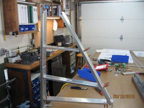

I worked on the vertical stabilizer and the rudder today. I got the frame of the vertical stabilizer all cleco'd up and up-drilled to the #30 drill bit. I also drilled for the hinge that attaches to the vertical stabilizer.I still need to up-drill the last top rib and the small nose rib. I will get this all riveted up when my new riverter comes in.

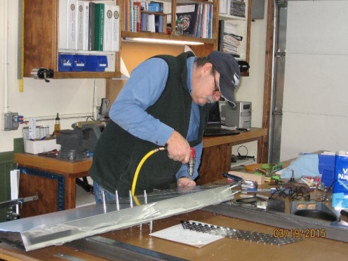

I was not happy with the way I trimmed out the rudder skin, so I decided to do this again. There was enough material left on the rudder skin to make the elevators, so I will just re-cut that to make one of the elevators. The new skin came out much better. I then marked the holes for the ribs and got the center and end rib drilled and cleco'd. I still need to locate and drill the holes for the rudder control horn.
Vertical stabilizer ready for riveting.

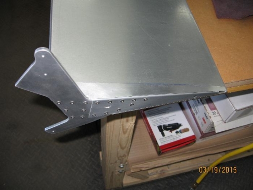

New rudder skin fits much better thatn before.
Drilling and cleco'ing ribs to rudder skin.
