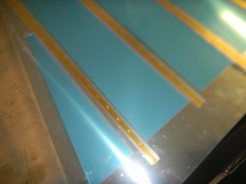

Cleaned up scotchweld and backriveted left skin
I took out all of the clecoes and cleaned out the holes from the excess scotchweld.
I then installed the -3 rivets and put on the riveters tape. Set the PSI to 40 and back riveted away!!!!!
rivets all taped up
putting on the riveting tape
