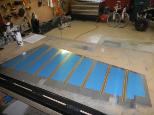

Tonight I roughed up the primed parts on the left sking and spread some scotchweld onto the stiffeners and clecoed them onto the skin. Ill let it sit for the next day or two and then clean the dimples and holes out from excess scotchweld.

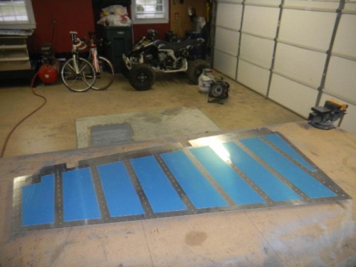

On the right skin I taped all of the rivets into the holes, set the compressor to 40psi and back riveted......Turned out great!!!
Left skin all scotchwelded up

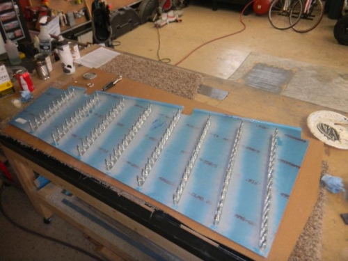

Rivets taped in on the right skin
Back riveting all complete
