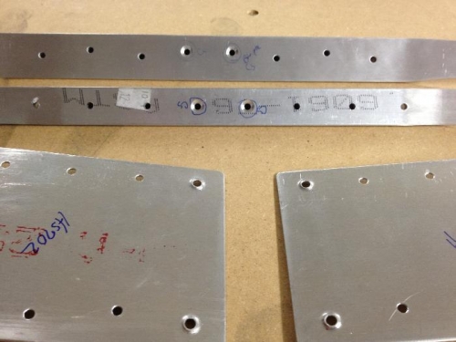

Counter sunk HS810 and HS814 and dimpled HS702

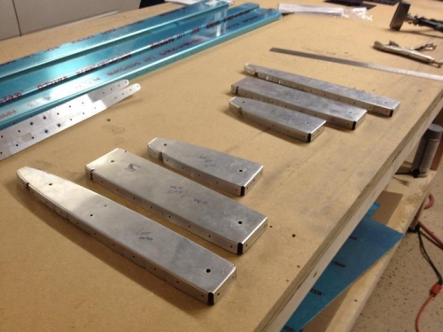

All HS ribs fluted and ready

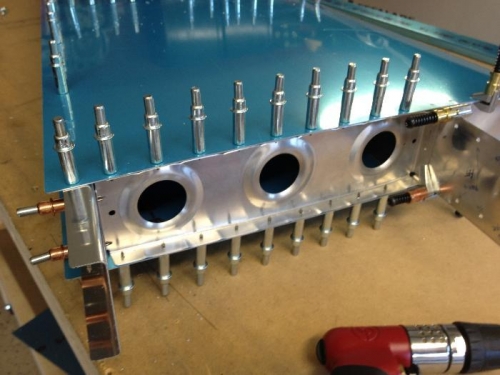

Skin is on and now I realize I need an angle drill for the dreaded 405,702,810,814,404 drill....
