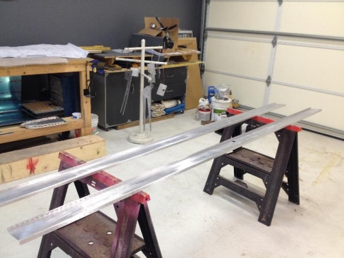

While the primer was drying I scuffed all of the rear spar parts and hung them up....the weather is going to be warmer tomorrow so hopefully I will be able to give it a good wipe down with some camp fuel and shoot them with some DLP50.

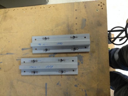

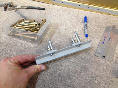

After the primer dried on the tie down brackets I Counter sunk the back of the spacers to accept the 3-7 rivets and then riveted the bracket, spacers and platenuts together.
Drilling Plate Nut Holes
Both Tie Down Brackets Done
All of the Rear Spar parts Scuffed and ready to be Cleaned and Primed
