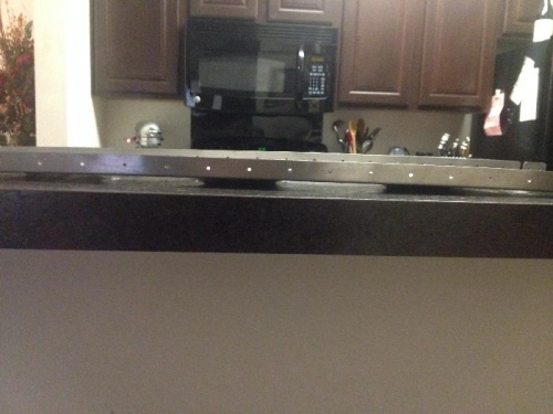

-Lay the rib flt on a table and press down in the middle of the highest bowed part.

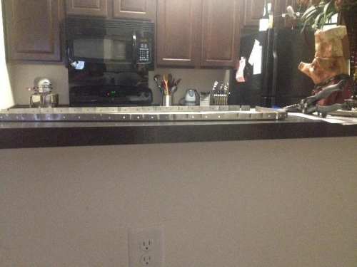

-Now starting from one end of the rib start fluting. When the tip of the rib just starts to rise stop squeezing. Do this same technique inboart to the middle and then do the same for the other end.
-Spin the rib around and do the same thing.
-This worked out GREAT. just a little fine tunning here and there and the rib was flat as can be....I set a timer and it only took just over 2 minuted per rib.
Got my vans order in...so tomorrow I should be able to get the tie down bracket that I messed up fixed and on getting the rear spars primmed.
The usual....see the bow
And after fluting
And after fluting

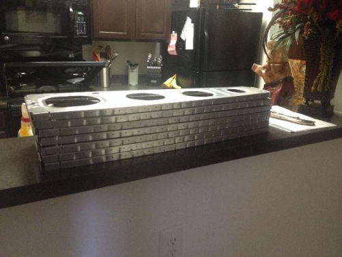

14 of the Main ribs on the left wing done
