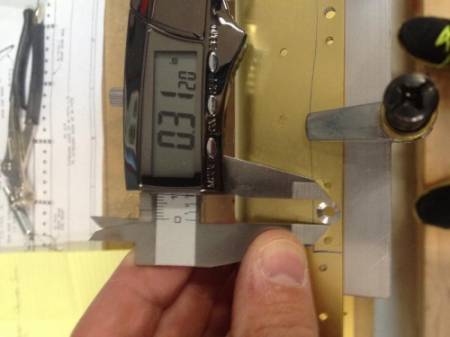

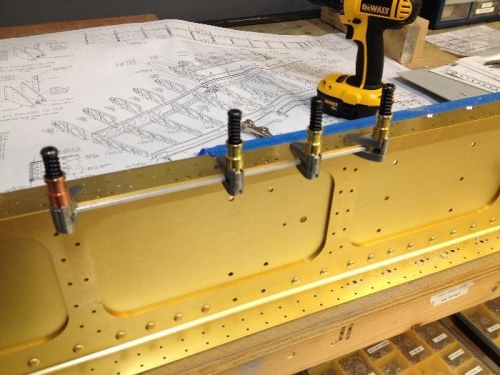

Good day in the shop today. I started off the day by using a jig that I built that would allow me to drill all the holes at once in each inspection cover. I drilled out each hole with a #28 bit, which is what the avery chart called for. I then used a #30 countersink which worked out well. I read on the VAF that a good countersink diameter is .312, so I set up my digital caliper and adjusted my countersink tool.

Jig Clamped in Place
#6 screw counter sink .312
