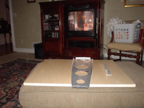

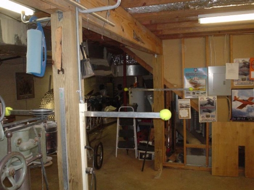

I purchased 8' of 1/8' thick aluminum angle at Home Depot and cut it in half for the wing jig. I then screwed it to my posts and leveled the arms. A few tennis balls on the ends should help prevent noggin injuries.I also took a square of plywood and sanded the edges to make a wing rib straightening station. I can then straighten and flute the wing ribs in front of the tv. I will use an aluminum angle section to help determine when the flanges are 90 degrees to the web. When I took the photo of the rib station (sounds like a BBQ joint) my wife was watching the Lifetime Channel (all chick flicks, all the time). Something tells me I will be watching more of the Lifetime Channel in return for my wife's permission to straighten wing ribs in the den.
Wing jig
Wing jig
Wing rib straightening station in front of the tv.
