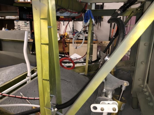

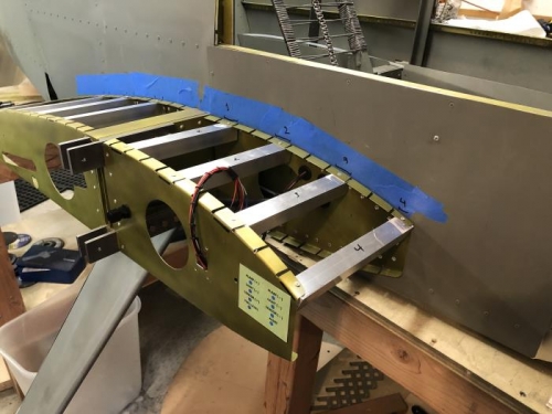

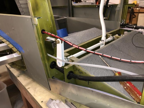

I've got the nose ribs for the starboard wing stub installed, and also installed reinforcements for the wing walk.I have cut out and pre-drilled the Deutsch DT connector port on the starboard wing stub, and run the starboard wing wiring harness from the connector point to various locations in the avionics bay. Terminating the wiring harness will have to wait for next time.
I also finished the installation of the fuselage fuel system, running the starboard fuel line from an AN fitting at the wing stub all the way to the fuel manifold on the firewall.
Once I get the wiring terminated, I can drop the fuselage to the floor and skin the stub wings.
