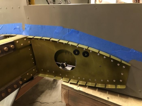

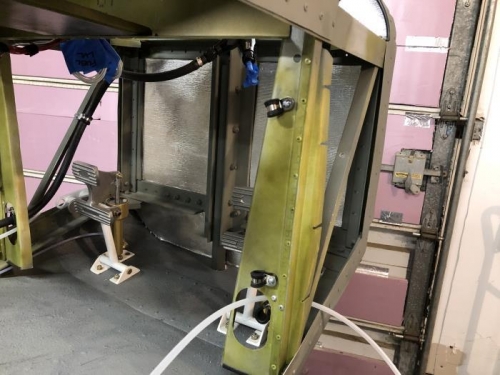

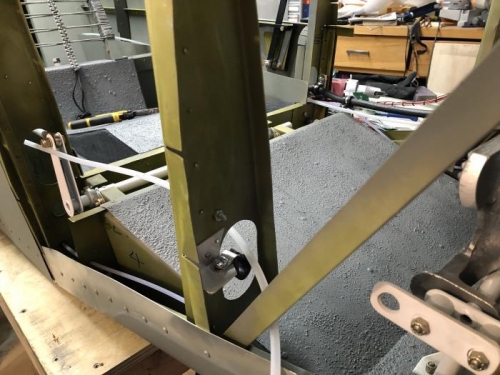

Brief Description:  Starboard Wing Stub
I have installed the nose wing rib on the starboard side. Prior to making it difficult to work in the tight spaces, I also installed the adel clamps for the wiring bundle and fuel line. One each at the side of the fuselage, plus another pair of fuel line clamps at F4 and the cross brace forward of F4. This matches the port side layout, which worked pretty well. I also put wire harness adel clamps on the aft face of the F4 starboard bulkhead. Lastly, I put gaskets into the rib/fuselage skin for the wire passthrough and for the pitot/stattic system. After having quite the challenge with the port side, I decided to make the pass-throughs larger,
