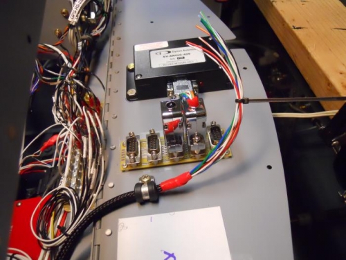

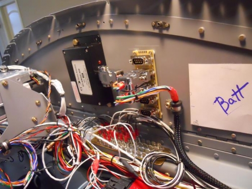

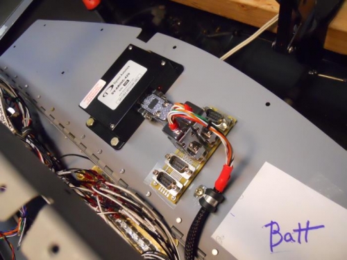

I had previously added another distribution hub in the bottom of the fuselage to which I had connected the ADAHRS, pitch servo and roll servo. I also had run a cable from that hub up to the panel area. I stripped the wires, added dsub barrels and assembled the connector to plug into the hub. I added an adel clamp and plugged the cable into the hub. I also started on the cable from the Dynon screen to the hub. I still need to mount and run the cable for the EMS module, but haven’t decided on a good location yet.
Cable that ties the two hubs together
Attaching cable & adel clamp
Cable finished
Cable finished
