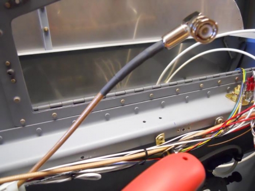

Brief Description:  Terminated antenna cable for A-210
While waiting for parts, I decided to terminate the antenna cable lead for the Icom A-210. Last time the wiring harness and trays were in the panel, I marked the cable for proper length. I cut the RG400 cable and used my handy-dandy Paladin stripper to prep the end of the cable. Crimped on the pin, inserted into the connector and crimped the ferrule. Added some shrink tubing, then checked continuity with the other end of the cable. All looks good.
Cable is ready for Icom radio
