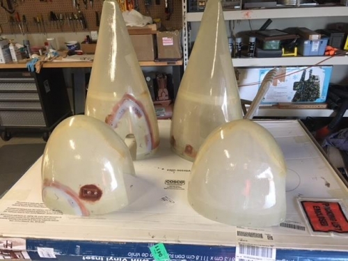

Slowly, I continue to work on the wheel pants/lower intersection fairings. I shot some test areas on the pants with sanding primer—wow, pin hole city! So, I sanded both left and right pants using 120 grit paper, then sanded both again with 220 grit paper. I blew off the dust with compressed air and wiped down the pants with MEK. Next, I mixed up some resin and applied to the pants using a brush-I also used this method to deal with pin holes on the cowling. Anyhow, I brushed on the resin and then brushed it again when it started to get real tacky. Tomorrow, I’ll sand the pants with some very fine paper and see if the pin holes have disappeared.—
After brushing on resin
