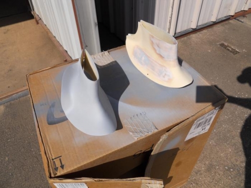

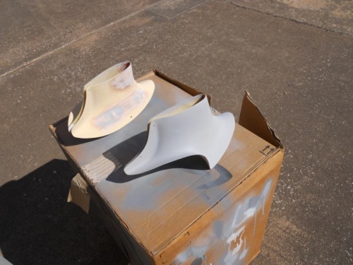

I confirmed with Dynon that I do have the incorrect fuel pressure sensor—mine only goes to 15 psi ( it is for a carbed engine). A replacement is on the way—a 50 psi for injected engines. This should clear up the problem on the EFIS. Next, I sanded both fairings with 220 grit, followed with 400 grit. Then, I shot a coat of sanding primer on each fairing. Tomorrow, I plan to lightly sand and get one more coat of sanding primer applied. I hope I’m about to get to the end of these fairings.
Fairings-one with sanding primer, the other ready
