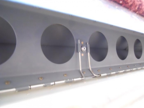

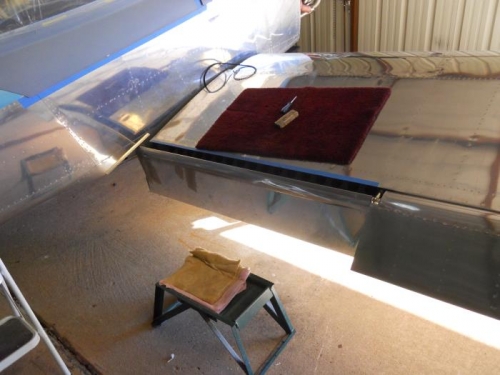

Today, I installed both left and right flaps. The pins seemed very tight, so I removed them and ran a scotchbrite pad over them. Then, I slicked them up with some BoeLube and inserted the pins. I secured the left side with a pair of hinge eyelets secured by a screw into a nutplate. As I was removing the hinge pin retainer on the right side, I dropped it and it fell thru a lightening hole in the flap spar. Dang it—and I don’t have a grabber thingie at the hangar to retrieve it. That will be on tomorrows “to do” list as well as connecting up the flap pushrods.
L. flap pin retainer
R. flap pins installed
