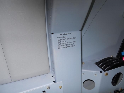

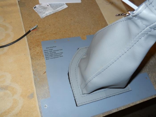

Brief Description:  Install panels and labels-final
See previous entry for more pics of today. I finished up installing the interior panels, then worked on labels. This took several trips in and out of the cockpit—about to work out a method for using a step stool which is about a foot shorter than where the top of the wing will be—that should make it much easier to get in and out. I did apply all the remaining labels—think I’m done with them until a DAR finds something else he thinks should be labeled. I used transparent decals printed with an inkjet. Then, the labels were sprayed with a decal bonder so that the ink won’t run. After that dries and the label is applied, I sprayed with a clear sealer so they don’t get scratched off.
Front stick button functions

Rear stick button functions
