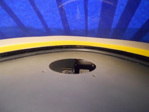

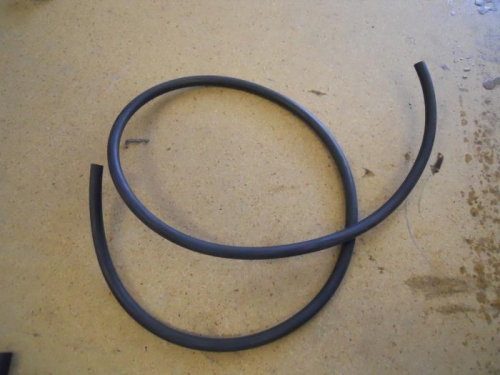

Brief Description:  Ran tubing between windscreen and glareshield

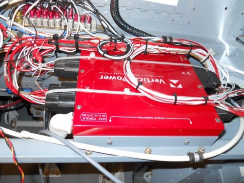

Misc. stuff today. I bought some 5/16” o.d. rubber vacuum line tubing at the auto parts store to dress up the inside where the glareshield meets the windscreen. I ran a bead of black silicone caulk around the area, then pressed the tubing in place. Still need to come up with something for the front of the glareshield—looks mighty sharp in the event of a really sudden stop. Next I ran some zip ties around the VP-X unit to ensure that the connectors cannot wiggle out.
5/16
5/16" vacuum line
Tubing glued to glareshield
Zip tied connectors on VP-X
