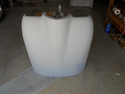

Brief Description:  Upper-final sanding primer applied
I cleaned up the upper cowl and shot it with another coat of sanding primer. While this was drying, I went over the lower cowl one more time with #400 grit paper and then cleaned all the dust off. I mixed some resin/acetone and applied with a foam brush. I’ll leave this to dry until tomorrow or next day. Later today, after the sanding primer on the upper cowl had dried, I lightly sanded with a very fine sanding sponge. Looks good—I’ll plan to shoot some primer tomorrow.
Upper-ready for final primer
