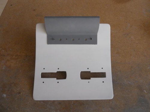

I sanded the micro which had been applied to the right side of the lower cowl and some other places. I believe the upper and lower are now ready for a coat of straight resin to begin on the pin holes. I also had been applying straight resin to the inside of the oil filler door each time I mixed up some micro for the cowl. It finally filled in all of the pin holes, so I shot a coat of sanding primer on it. After dry, I lightly sanded then shot a coat of high temp white paint—same stuff that I used on the inside of the cowl. Next time I mix some resin, I’ll mix a small quantity of flox which I can use between the door and the hinge. Then, I will rivet the hinge to the door.

Inside of oil filler door
