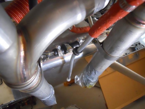

Wow, hot day today. Spent most of today doing yard work, but did finish up mounting the sniffle valve tube. I attached an adel clamp to the aluminum tube and another clamp to the tube that supports the exhaust pipes. Not much working room there—had to safety wire both clamps together in order to get a screw thru them. All secure now and sniffle valve is done. One more item I can check off of my list.
Tube secured
Tube secured
