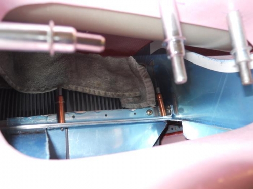

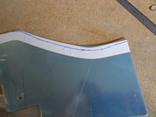

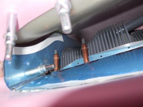

I continued trimming the side baffles until the top cowl would sit down on the lower cowl. I added paper clips and installed the upper cowl once again. I measured from the top of the paper clips and made a mark for .4” clearance. Removed everything, connected the marks and trimmed to the line. Installed once again just to be sure of the clearance—looks good.
Final trim line-L. side
Looking in right cowl inlet
Left cowl inlet
Left cowl inlet
