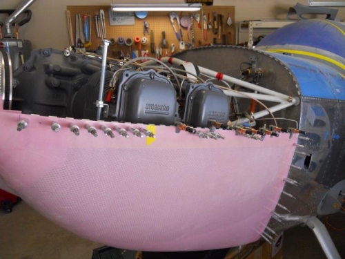

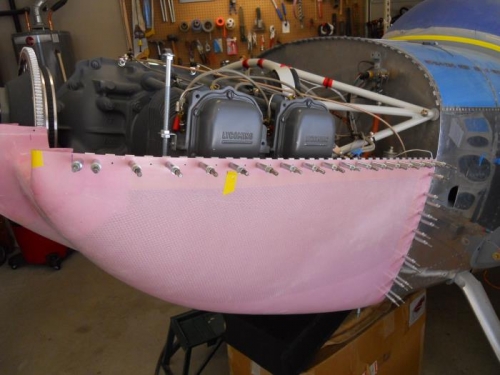

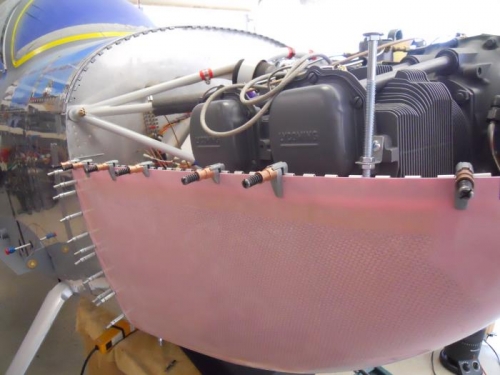

I cut a piece of hinge for the lower cowling horizontal attachment, then drew a center line on the hinge. I laid out holes every 1”, center punched and drilled to 1/16”. Then, I drilled them up to a #40. I had to remove the vertical hinge and trim off about ½” on the cowl side so that it would butt up against the horizontal hinge. I clamped the hinge to the cowling and used my angle attachment to drill thru the hinge into the cowling, clecoing as I went along. I let the hinge make a slight rise toward the aft end like the plans show, but I don’t see how that will make the pins any easier to remove. Then, I made a repeat of the process for the right side. Next up is to get the upper hinge drilled to upper cowling.
L. side hinge being drilled to cowl
L. side complete
L. side complete
R. side clamped, ready to drill
