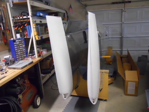

Brief Description:  Cleaned up & installed tips
I cleaned up the inside of the tips where I had bonded the backing strips. Lightly sanded to remove the sharp edges. Next, I replaced the temp nuts on the back of the Aeroled mounting brackets with some #6 elastic nuts. I ran the retaining pins thru the hinges—well most of them. I found one eyelet that had some dried resin blocking the pin. I picked at it with a paper clip until I got it cleared. Then, I installed the wing tips onto the wings. Some of the pins are pretty tight toward the last few inches—maybe Boelube will help. Calling the tips done—at least for now.
Tips installed
Tips installed
