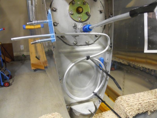

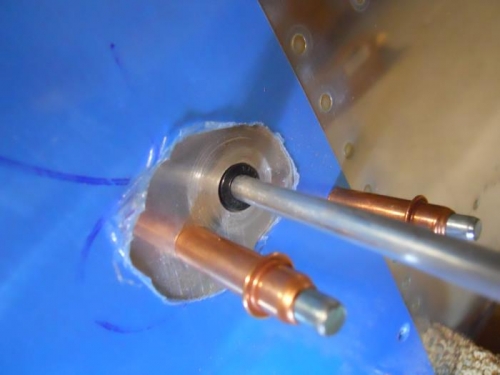

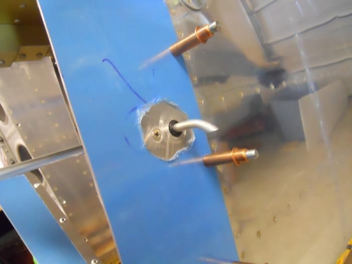

I shortened the right vent tube a bit, then put a slight bend in it and cut an angle to point the opening directly into the wind. Then I began a repeat of the coiled vent process for the left wing. I got the support bracket fabbed and drilled to the wing skin. Then I bent the tubing—much easier after having done it for the opposite wing. I cut the tubing, made sure to install the nut then flared for the fitting. The rest of my day was spent putting up Christmas lights
R. wing-vent tube exit
Curved and cut vent tube
L. wing--got the coil & support bracket done
