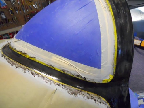

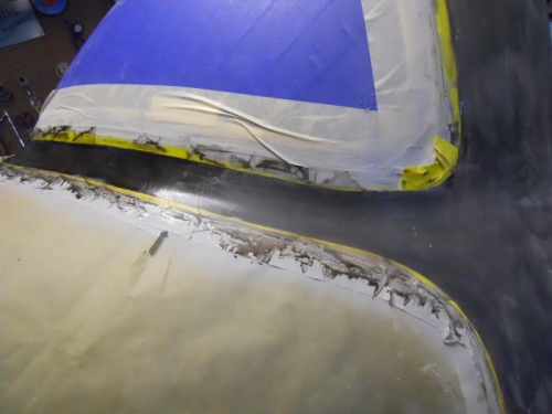

I sanded my trouble spots over the bow—still have some depressions. I mixed up some Super-Fil and applied. Later, I sanded it down-finally got it smooth across the top. Next, I mixed up some straight resin and applied over the entire fairing. This evening, I began sanding it down—didn’t get very far before the humidity shut me down. I’ll finish sanding tomorrow, the hit it with some sanding primer.
Coated with pure resin
Began sanding the resin coat
