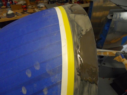

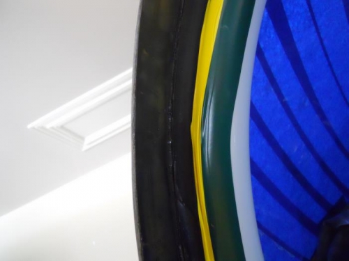

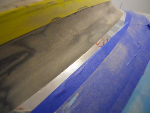

This log covers several days. I sanded everything one more time, applied a micro mixture, let it cure, sanded it. I removed the tape around the lower windscreen to skin—this area is beginning to look like something I can live with. I re-taped, and mixed up another batch of micro. I spread this on several areas on the forward fairing—was planning on spreading on the bow, but it cooked too quickly. I mixed up another batch of micro. There are 3 spots over the bow where I can feel low areas. I spread a fairly thick layer on each of them. The glass on the inside behind the roll bar was not real smooth, soI mixed up one more micro batch and spread it with a credit card. I don’t want a thick build up, but would like to smooth it out. Next session-MORE sanding!
Front edge after pulling tape
Glass on underside of fairing
