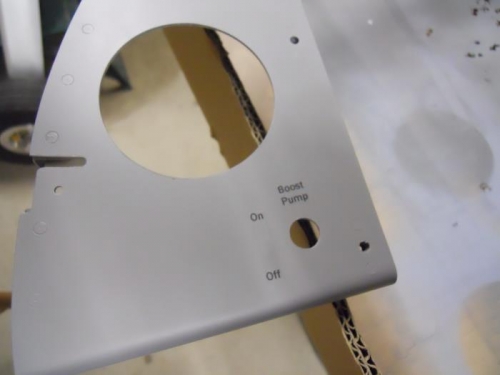

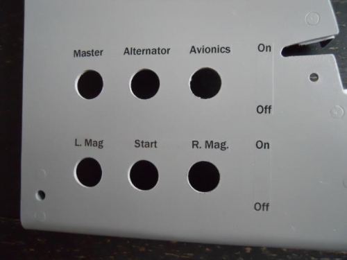

Panel Label Fun!! I needed to get the subpanels lettered in order to get them riveted in so that I can begin riveting on the top skin. I looked at plenty of build logs, checked all the VAF posts, talked to Stein and finally decided on a plan. There are a zillion ways to label panels. I chose to use water slide decals—just like we all did with model airplanes. I printed up various labels for switches, lights etc on plain paper, cut them out and placed them where ever they would eventually end up. I tried various font/point combinations until I found what I liked. I then printed onto some Testor’s Water Slide Decal paper (found this at Hobby Lobby). After printing on the decal paper, I sprayed the sheet with Testor’s sealer (also from Hobby Lobby). This keeps the ink from smearing or running when dipped in water. I used some 1/16” painters tape on the panel to lay out location of the various labels. I cut them out, dipped in water and slid the decal off the backing paper onto the panel. Wasn’t that difficult—only messed up a couple. I had printed multiple lines of the same item just in case. After the decal was dry, I sprayed over it with a matte finish clear spray--gave it 3 coats. You can faintly feel the decal and the clear label is slightly visible, but not that noticeable. I still need to apply the labels for varioust switchs down on the arm rest, but that can come later—I’m more interested in getting the top skin done.
Right side of sub-panel with decals
Left side of sub-panel with decals
