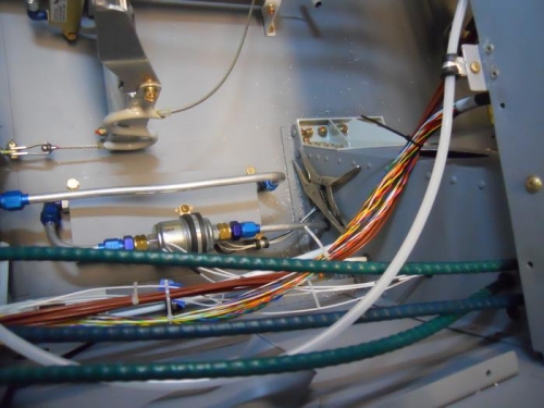

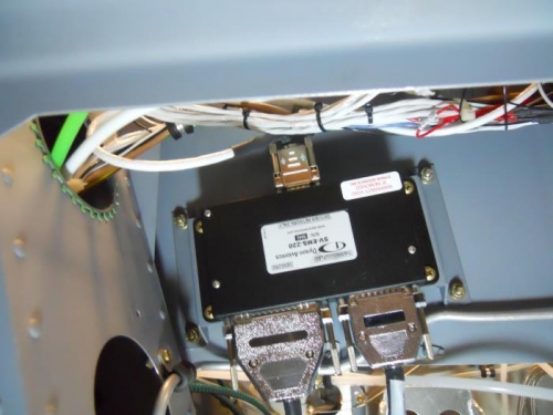

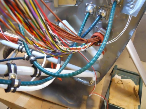

I received my EMS wire kit a few days ago. I wanted to make sure I had a good location for the EMS before permanently mounting. I added the 2 wiring harnesses from the kit—looks like the location will work ok. I previously had clecoed the EMS mounting bracket to the F866A-1 lower baggage bulkhead. I match drilled the holes up to 3/16” and secured the EMS with #10 screws. I ran the bundle of wires thru the firewall pass thru—now just have to figure out which ones to attach to what device. I need to fab a small bracket that I can attach an adel clamp to in order to support the bundle of wires as they pass by the forward face of the left gear tower.
EMS mounted to bulkhead
I'll attach bracket & adel clamp to front of tower
Mess of wires exiting the f/w pass thru
