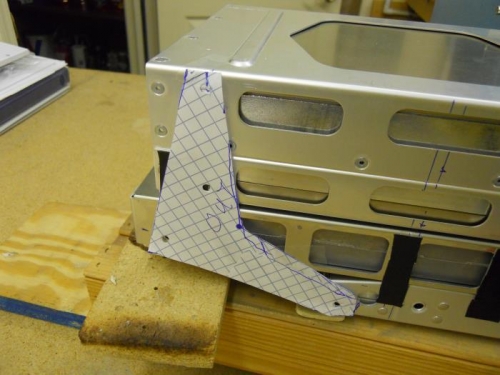

Brief Description:  Radio tray rear support-1

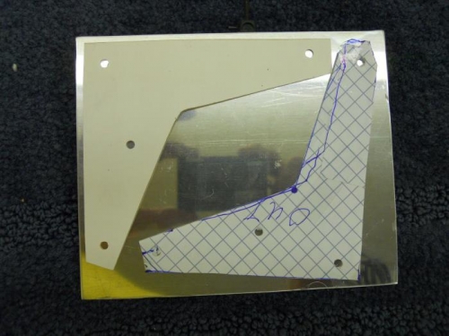

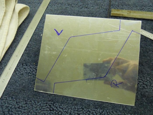

Spent a lot of time drawing out various types of support for the rear of the radio trays and finally came up with a design that should work. I cut and taped a paper template until I got the approximate shape I wanted for the rear support of the radio trays. Then, I transferred the paper template to poster board and finally laid out on some .063 scrap—used the piece that I had previously cut from the panel for the radio stack.
Rear support-paper template
Transfered to poster board
Rear support laid out on .063
