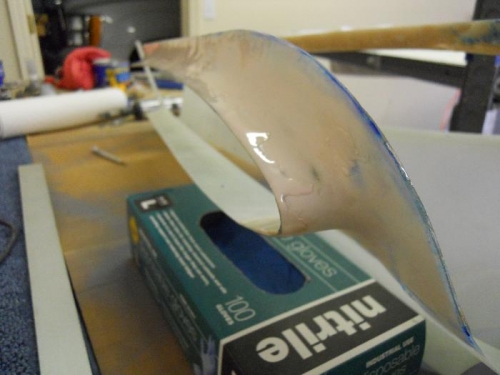

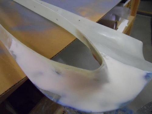

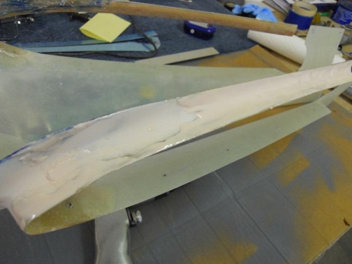

Today I sanded the micro which I applied last night. I used some 80 grit paper which took the excess off quite easily. I have a couple of areas that need just a small build up, but overall it came out pretty well. I mixed up another batch of resin and added 2.5 scoops of micro to make a stiff paste. I applied this mixture to the few low spots in the front area and then spread a coat along the remainder of the lower fairing on both sides.
Frontal shot-right side
Added micro to lower fairing-right
Micro applied to lower fairing-left side
