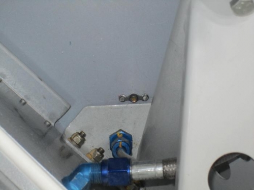

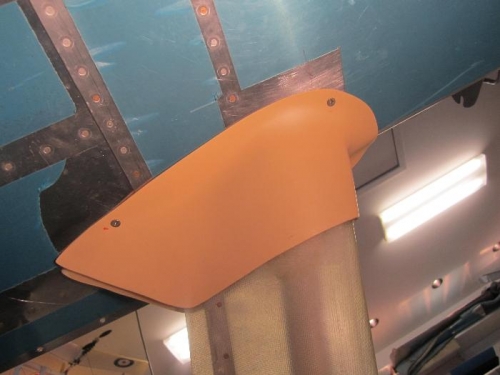

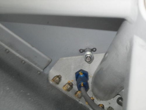

Before I removed the main gear legs I fitted the gear leg to body intersection fairings. I discovered I could put to #8 screws thru the bottom skin and install platenuts, just forward of the gear weldmount and aft of the wing spar. So I drilled the holes, and installed these platenuts. I may have to install another fastner on the outboard part of this fairing, but I'm going to wait until I reinstall the wings.
2 screws hold inboard part of this fairing
Platenut just fits in front of weldmount
Platenut fits.
Platenut fits.
